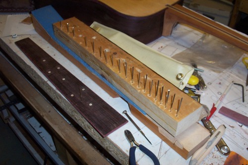

A bit more pics and a bit more jigs towards the end of no 2, here is a fret organizer that i made, inspired by Mario! Thanks bud!

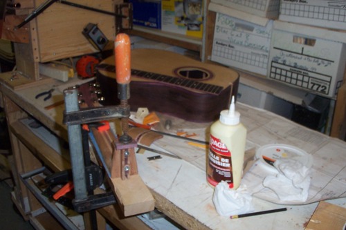

Fretting halfway!

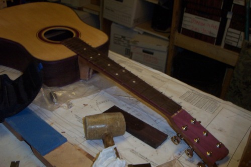

Frets all in their slots
frets all filed up and trimmed and glueing of the heel cap

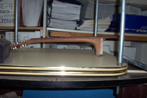

glueing of the fretboard to the neck

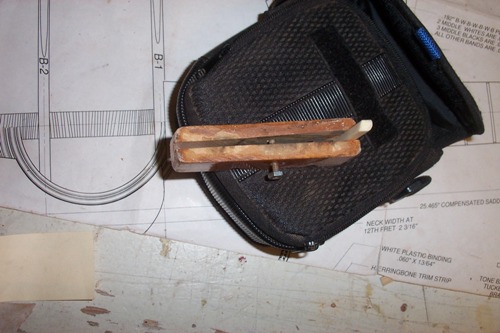

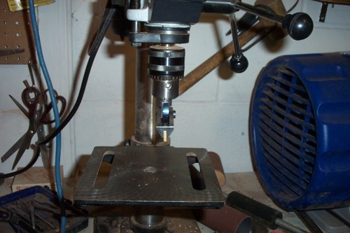

Here is my nut shaping jig, inspired by Bruce Dickey's idea in the jig section here!

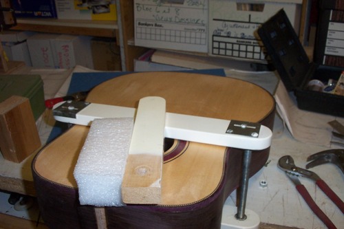

Scrounging must be my middle name, i recuped an old rocking chair and cut the swing out of it to make that dome leveling sanding jig found also in the jig section here!

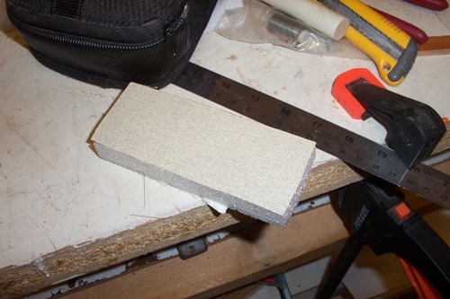

80 grits on one side of the pad

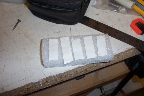

double-sided tape on the other side which will stick to the swiveling arm which has one of the rocking chair's bearing
The jig ready to sand level!

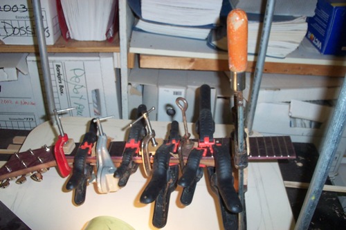

Some more of the neck and fretboard without clamps

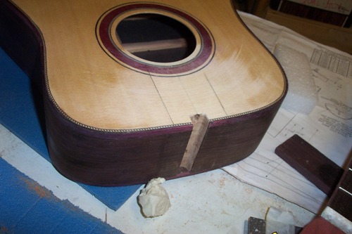

Serge,
I'm trying to figure out what you're planning to do with the neck in the go bar deck. Can you elucidate?
I like that rope purfling. I have something similar, but not as nice. Where's yours from?
Lookin'good Serge!!
PostPosted: Sun Jul 09, 2006 3:21 pm
Thanks a lot Pat!
Okay, i must admit something here......i'm far from being a NEAT FREAK like Hesh and found some room in the go bar deck to leave the neck to glue!
